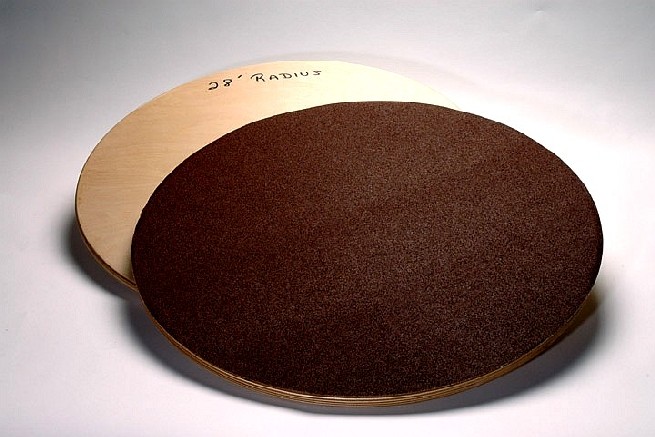

I use round ones because it fits into my go-bar deck easier. They are 24" in diameter, and the base of my go-bar deck is 24", but with the roundness of the dish I can put it into my deck and not hit my threaded rods in each corner of my deck. I'm offering these dishes for sale now, but my website is not complete now(will be in about 2 weeks). I use 13ply birch at .75 thick that is finished with shellac, and 80 grit heavy duty sandpaper. I sell them for $125 for 2, or $70 for one. You save more if you order 2. If you don't want sandpaper you can get 2 for $99, or 1 for $55 without sandpaper. This is a great deal for birch dishes which no one out there sells. Anyway, good luck!
ps, here is a pic

PostPosted: Fri Apr 01, 2005 4:28 am
Posts: 688
For backs I have 12', 15', 16', 20' and tops I have 25', 26', 28', and 30'. I can also customize the size of the dish or the radius to any shape or radius for $25 more.
